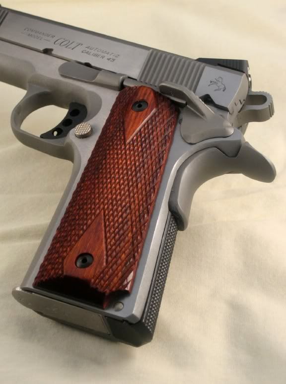

I gave my Colt Combat Commander a new look.
5 reading
4.4K views 17 replies 9 participants last post by  Richard
#1 ·
I took off the arched stainless MSH and replaced it with a flat black one. I also replaced the silver trigger with a black one. I was a little nervous about completely disassembling the gun to add the trigger but it is really a simple 5-10 minute process.
I think the black accents really look good on a stainless gun with rosewood grips.
This is a crappy pic using the flash but you get the idea. :)

BTW: If there are any of you out there that, like me, have never replaced a trigger on a 1911 and are curious how far you have to tear one down to do it;this pic should answer your question. You pretty much have to tear it down completely. The only thing you do not have to remove is the firing pic assembly. :)
PS: I also ordered a new stainless MSH and put it on my other COlt Commander. I also took the silver trigger from the XSE and put it on the standard Commander too. Before it had a black solid trigger and a serrated plastic MSH. It is amazing how something as small as a trigger and MSH can make such a difference in the look and feel of a gun.
