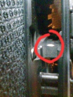

      That's not the feed ramp edge I'm talking about.
      That is the frame under where the feed ramp on the barrel sits. Mine has a little scuff mark there but certainly not as much wear as yours has.
      I'd have to agree with you that something is off with that much wear.

      You were talking about this edge then?
      HGF Forum Moderator
      2,504
      Yes.
      I just don't see how you are getting that much wear on the frame. Unless the rounds are taking a serious nose dive when the slide pushes on them.
      You can't see very well in the photo, but mine just appears to be scuffing from the nose of the bullet as the round comes up from the mag.
