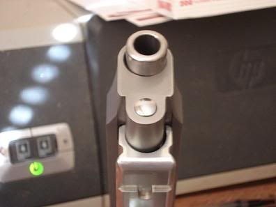

    First of all I am brand new to shooting handguns so bare with me. I baught the Taurus PT92 last week and have put 400 rounds through it. I have been having a problem with the slide not locking open after the last round has been fired. Does this have anything to do with being new? Could it be because my grip is too weak and I'm absorbing most of the recoil with my hand/wrist?
    Also I've noticed that the barrel sits slightly closer to the left part of the slide when I look directly down the barrel. Is this normal?

    Easy there Southpark........I'm not talking about pointing a loaded gun at my face. Please let me rephrase....When I sight down the barrel (barrel pointing at the target) I notice the barrel to sit slightly closer to the left part of the slide. Just wondering if I should be worried about this or if it is normal with this type of gun?

    Check out this thread First Outing w/ New PT99 AFS
    Seems to be what you describe about the barrel and slide fit.
    What you are describing could be normal.

    Perhaps you should post a picture, as to make it easier to answer your question.

    This is what I saw with the one taurus version 92 I was able to check out.. Along with the wiggle-play that was mentioned in that thread where the front of the barrel doesn't lock immobile in the slide. That was the thing that left me totally unimpressed with their version verses the beretta 92.. Even though folks have said to me they're as good a gun, despite not being as completely well-finished or slicked out as the beretta.
