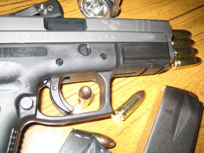

    Brought it home tonight.

    Your new toy looks great, enjoy.
