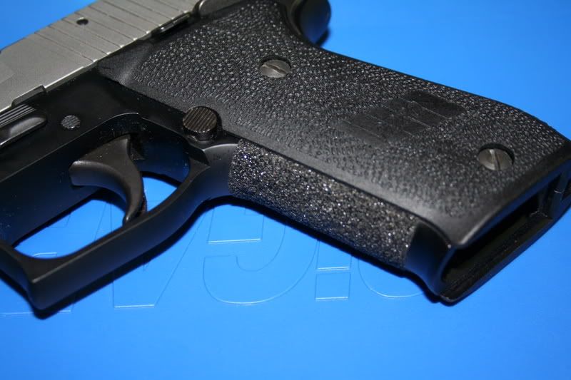

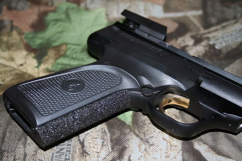

    I have used the tape on a couple of guns with horrific to great results.
    Browning Buckmark
    Sig 220 SAO
    I tried it on my Springfield (honest to God blued) and it didn't fare so well. The bluing looks like crap now that I removed the tape and it wasn't on that long. I'm not upset as one of these days the gun is going to go to Springfield for custom work and I plan on having the front strap checkered and the frame bobtailed which will require refinishing anyway.

    It works OK, it flakes off at times and for some people it's too aggressive, I took some sand paper to the tape and it was still grippy without being too rough. It worked well with my Sig and I love it on my Buckmark.
