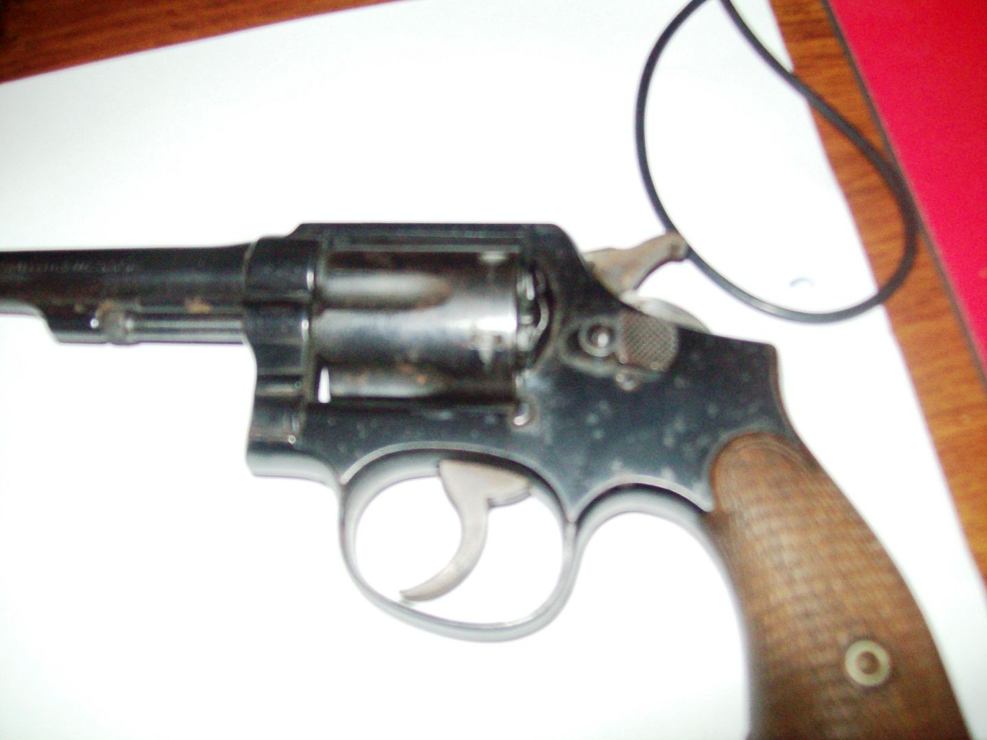

    Can some one help me out as I am confused as to what I have. I bought what I thought was a .38 special, police issue. However, after buying 2 boxes of shells for it, I looked at the barrel and it is stamped 38 S&W CTG, no special or spcl, nothing in-between. The previous owner said he never shot anything but .38 special rounds in it. All the serial numbers match, including the chamber. I dropped a 38 special round in it and it fits perfect. I looked it up on line, comparing both 38 S&W and 38 Special, it has characteristics of both, but not an exact match to any I found. It does not have the stamp in the cover on the side, but the cover on the side matches a 38 S&W, along with the strap ring on the bottom of the grip, which is wood, but has no round inlay at the top. The serial number is 670433. The barrel is marked Smith and Wesson, but nothing else has any stamp, other than made in USA. There is an odd ball number stamped in the side visible after opening the chamber, which I figure could be the police issue number. So my questions are:
    Is this really a 38 S&W or ??
    Is it safe to fire 38 special rounds in it as the fit perfect and the chamber closes?
    Year made or any history?
    Why does it not have the stamp in the side cover or grips like the others?
    Is this a poor copy of a real Smith?
    Anything else you can tell me would be appreciated......D..........

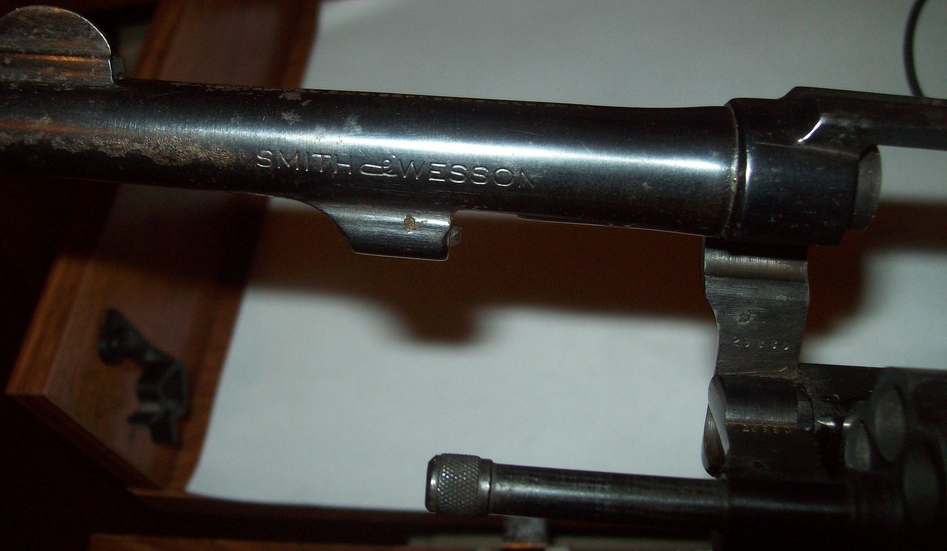

    Pictures would help.
    From the markings you quote, it might even be a cheap Spanish copy of a S&W revolver. If that's correct, it may not be safe to shoot.
    S&W made lots of revolvers to fit each kind of cartridge, but never made any to fit both. It wouldn't've been safe.
    The .38 S&W cartridge is both shorter and larger in diameter than is the .38 Special. But if the pistol's cylinder is just barely long enough, and if it has been bored straight through rather than having been chambered for a specific cartridge, then .38 Special rounds will slide easily into the chambers of a .38 S&W cylinder. However, if you fire .38 Special cartridges in a bored-through .38 S&W chamber, you are just asking for a very destructive "KABOOM!" because the .38 Special is a more powerful round than is the .38 S&W.
    Pictures. We need pictures. Make sure to show all of the markings on the gun, including inside the space in the frame into which the cylinder's "crane" fits.

    Ok, got the photobucket thing done. Now, before I get hammered, I have not touched this weapon, it is exactly like I received it, no cleaning no nothing, so yes it looks bad. I did not want to refurbish it until I knew just what it was I have as that could take away the value of it. If you need more or better pictures, just ask and I will try to get what you want. I tried to get every angle and uploaded the high def shots, so they may be a little big if you try to open them. Again, thanks for your help and info!....D......
    URL: Pictures by dmandrewsfamily - Photobucket
    4,110
    It's old. Only the old ones have four sideplate screws, I think.
    I believe that it might be the .38 Hand Ejector M&P 2nd Model of 1902. The serial number on the frame (inside the crane cutout) is in the correct range. It was probably made in 1902.
    The cylinder is a later replacement, with a much newer serial number.
    This pistol was made to fire the .38 S&W cartridge. The .38 Special cartridge hadn't been invented yet.
    The newer cylinder may indeed be one made for .38 Special. It seems bored-through, rather than chambered, but I can't see for certain.
    If this gun has been fired with .38 Special cartridges, its previous owner has led a charmed life. The lowest-power .38 Special load, a 200-grain bullet at about 750fps, is 100fps faster than the highest-power .38 S&W load, and thus at higher pressure.
    The .38 Special cartridge is 0.379" in diameter, while the .38 S&W is 0.386" in diameter. The .38 S&W cartridge won't fit into a .38 Special chamber, but a .38 Special will easily slide into a .38 S&W chamber. However, the .38 Special is 1.55" long, while the .38 S&W is 1.20" long.
    Bullet diameter is also different. The .38 Special uses 0.357"-diameter bullets, while the .38 S&W uses 0.359" bullets. Thus, if the gun's barrel was made for .38 S&W, .38 Special bullets will be loose and fire inaccurately.
    When the new cylinder was added to the gun, it may have been rechambered from its more modern .38 Special to the older .38 S&W. This needs to be investigated by a competent gunsmith. If it has indeed been rechambered to .38 S&W, the .38 Special will fit, but will be dangerous. However, it will be safe using .38 S&W loads.
    It seems to have its original finish. If this is indeed true, do not repolish it. Clean the rust off with a coarse-linen, oily rag. If that doesn't work, try lightly-oiled, end-grain balsa wood. If all else fails, very carefully use oiled, 0000 (ultra-fine) steel wool, but only on the rust.
    The grips seem to be original. Clean them with an old toothbrush, and then rub-in a little boiled linseed oil using another old toothbrush.

    D.Andrews is offline Junior Member
    Oct 2012
    The serial number on the chamber matches the number on the underside of the grip as well as the underside of the barrel, so all 3 serials match, which tells me that the chamber is original to the gun. One of the things that bothers me is that when a 38 special round is in the chamber, it looks right, the lead is in the smaller section of the chamber and is not far back from the end of the chamber so the bullet wont travel very far in the chamber. A shorter round would be more back in the chamber, more back than the smaller part, and would have to travel a good ways before reaching the end of the chamber and entering the barrel. Is that safe and normal?
    The only operational issue I have noted is that the lock pin that hold the chamber in place has a little slack to it. Would replacing that take away from the value? I havent cleaned it for the reasons listed above as I dont want to ruin it or take away from the over all collectability of it.

    If the cylinder's serial number is the same as that of the rest of the gun, then it's a Model 1905 Hand Ejector, made between 1905 and WW1.
    I believe that it's still a .38 S&W pistol, though.
    The final test, also to be administered by a competent gunsmith, would be to clean, "slug," and measure the inside diameter of its barrel, both groove and land. A groove diameter near 0.357" would indicate a .38 Special, and anything larger, say maybe 0.360", would indicate a .38 S&W.

    "Your pistol sounds very much like a British Service Revolver, a model that was a precursor of the British Victory guns. You can call it a pre-Victory, The .38 S&W (not .38 Special) was the barrel stamp on guns that were chambered for the British .38/200 round, and the BSRs were in fact called the K-200 by the factory for short. Your gun was probably manufactured and shipped in February or March of 1941. The company was turning these out at a pretty good clip under a British contract, and it is fairly easy to interpolate ship dates.
    Most BSRs had five-inch barrels. Many of these guns (and the subsequent Victories) were released to the commercial market after WWII had concluded. Some were bored out to take .38 Special rounds and many had their barrels cut to two inches. If you still have the long barrel and cannot chamber .38 Special, you have an unmolested gun. That makes it a little more interesting as a historical specimen."
    I read this off the S&W forum(not this S&W forum) which has a plethora of information on pistols such as this one. That being said, I believe you have a 38 S&W bored out to 38 special as I do not believe you could chamber a non bored out 38 S&W chamber w/ a 38 special cartridge. Likewise I do not believe your gun is a 1905 Hand Ejector because as far as i can tell the 1905 was never chambered in 38 S&W and besides the Limeys really liked those large lanyard loops(a distinguishing feature of the V- Model).
    4,110
    denner;
    1. Where did you get ".32 S&W"? Nobody had mentioned that round until you did.
    2. I doubt British government ownership, because I don't see a "broad arrow" stamp on the gun. However, the "Made In U.S.A." marking might indicate an intention to export.
    3. The idea that it was a .38 S&W pistol purposely bored-out to .38 Special seems to be correct. It's nice to know that it was a factory job, which indicates that it's safe to use.
    4. Whoops—I missed noticing the lanyard loop. You are probably more correct than I am. Maybe it's a Victory Model, after all.

    Sorry Steve I'll fix it, meant 38 S&W: This is the pistol I believe:
    Model 10 British .38/200 Caliber Service Revolver (1941-1944) K-Frame 38 S&W Military & Police rechambered in 38 special. Sidenote is that the pre-victory model may be worth more to collectors?
    The serial number should denote the date of manufacture and as far as I can tell it falls in the WWII period. The 38 S&W was designed for the British .38/200 round.
    Heres a little history which might clear things up: http://en.wikipedia.org/wiki/Smith_%26_Wesson_Model_10

    Now you have me even more curious. Why would you need to bore and rechamber it for the .38 special round when it is smaller in diameter, and the projectal is as well smaller? I can see where it would not be accurate at all however. I havent measured it yet or bought any 38 S&W rounds to try in it for fit as of yet. That will be in the near future.

    D. Andrews, did you read what I posted above including the wikipedia link describing this gun? If you were to (read) more closely you should find your answers, or at least most of them in your quest for information. I found this information with not too much trouble from the S&W forum and my own limited research. Likewise, The S&W forum, not this S&W forum is the place to be regarding this particular at least 71 year old S&W pistol. As you stated you do not want to spend the $50.00 to get an authentication certificate, so the S&W forum is your next best option in my humble opinion. I posted above regarding a plethora of information and folks that know about these pistols from the S&W forum which instead in my opinion would a better option than being spoonfed from the post here, but you're on the right track. "Rechambering of .38-200 cylinders to .38 Special results in oversized chambers which may cause problems": from the wikipedia link I posted above. It should work as evidently the previous owner has shot 38 special from this gun with no ill effect and as you've stated the 38 special cartridge seems to chamber fine in this pistol, but take that w/ a grain of salt as "may" means "may" cause problems or it may not.

    The 38 special is smaller in diameter, but longer and a more powerful and popular cartridge(especially in the U.S.) I would not buy or use 38 special +p's in this pistol, just stick w/ 38 special.The reason you would have to rechamber in order for the 38S&W to shoot 38 special is because the 38 special is a somewhat longer cartridge. The .38 Special is 1.55" long, while the .38 S&W is 1.20" long.

    Quote Originally Posted by denner View Post
    ...[T]he 38 special is smaller in diameter, but...longer and...more powerful...
    Mr.(?) Andrews;
    Please see the accurate dimensions I gave you in Post #8 of this thread.
    If you fire a .38 Special cartridge of sufficient power in a larger-diameter .38 S&W chamber that had been merely lengthened to fit it, you risk either a split cartridge case and its released attendant hot gasses and brass particles, or even a full-fledged explosion and a ruined cylinder. In either case, your hand will suffer in the extreme, and you could even lose a finger or two.
    If you continue using .38 Special cartridges in this revolver, I strongly suggest that you stick to the very mildest, low-velocity loads.

    Correct if I'm wrong, but I believe as a safer option would be to shoot the lower powered properly dimensioned 38S&W cartridge from this rechambered pistol(perhaps more accurately as well). I was reading on the S&W forum of problems shooting 38 specials in these rechambered pistols and the advice to stick w/ the 38S&W cartridge, but please check on that one. Case bulge and what Steve has stated would definately be a concern shooting 38 specials from this 71 + year old lend/lease re-chambered pistol..that baby is a piece of history for sure.
    4,110
    Dang! I think that you're right again, denner.
    I must be getting senile earlier than I'd expected.
    However, there'd be one heck of a freebore jump, from the mouth of the .38 S&W cartridge to the barrel's forcing cone.
    My thought was that a low-power .38 Special might not bulge or split.
    But why take the chance?
