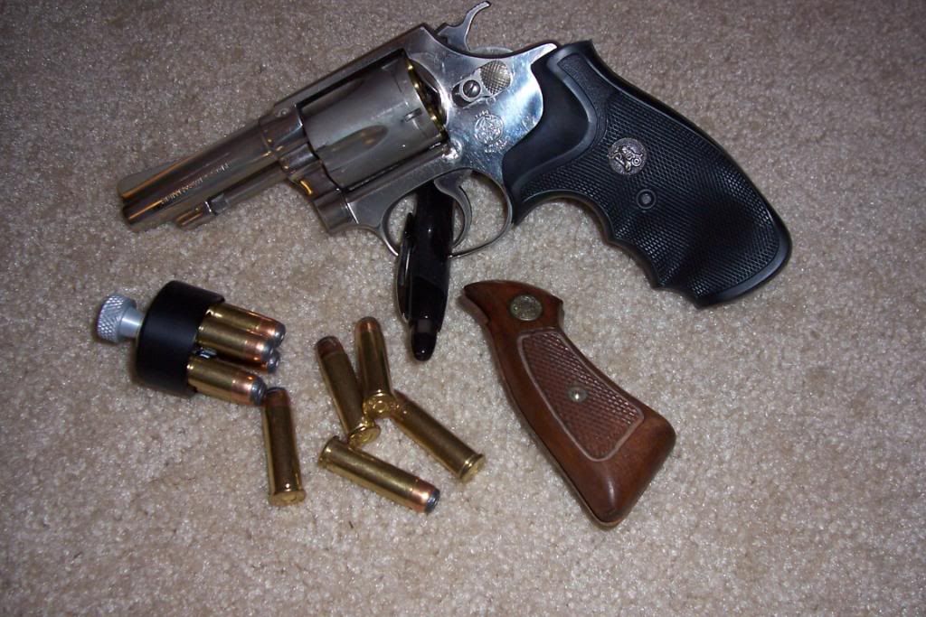

    Here are a couple of pictures of the gun. Sorry for the quality, seems like the nickel finish reflects the flash right back. As you can see I still have the original grips having just put the Pachmayr's on recently. They make it much more pleasurable to shoot. you can also see where the gun was in the holster for so many it dulled the finish on the cylinder. I just didn't know it would do that.

    Marty that's a real beauty even despite the dulled finish on the cylinder....and don't feel bad....I once stuck my 1911 under the drivers seat of my car not realizing it was directly over the exhaust pipe, which brought up the condensation in the carpet and rusted my blue job after a few days....so you're certainly not alone in the "boy I wish I hadn't done that" department.
    I sold my 3" Model 36 in order to carry a heavier off duty gun because of the lack of high performance .38 Special ammo in those days and I have been kicking myself ever since. Since your gun was made in the 1950's, am I correct in saying that the serial number is probably on the bottom of the butt, not in the yoke recess of the frame? If so, it will be helpful for the factory to know that fact.
    Let us know what you find out. Best wishes.
