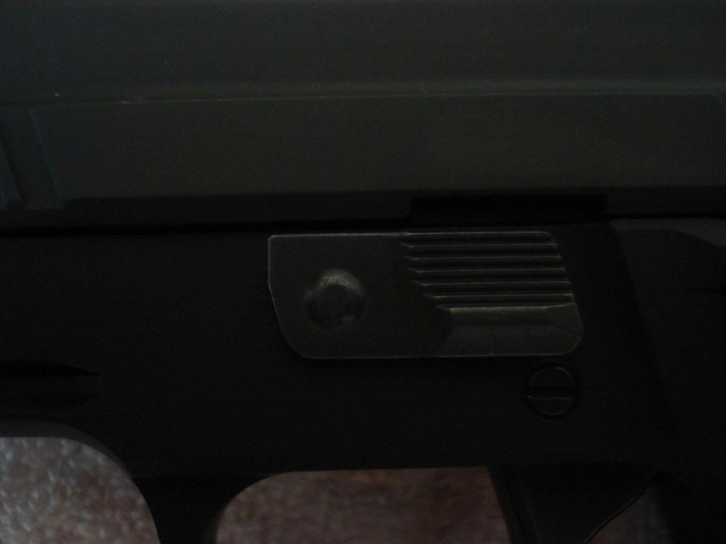

    Here are one of the guns in question. my brand new sig 229 elite dark

    The lever doesnt move a whole bunch but it is pretty clear from the pics that it does move. is this something i should be concerned about?
    I wouldn't think so really. It's not getting anywhere near where it has to for the slide to be affected.

    do you know why is the lever even moving in the first place? does your sigs lever move that much too devil?

    It moves that much because of the way SiG designed their lock-up lug/barrel as a single piece assembly, unlike that of the Beretta 92 seires or 1911's for example. When the slide is back, the muzzle of the barrel tips up as the lock-up lug drops down. In the process it comes out of contact with the cross bar portion of the take down lever, that lack of tension causes the slight droop. When the slide is in full battery, contact with the cross bar locks up the action and the take down lever sits higher. Nothing to be concerned or worried about.
