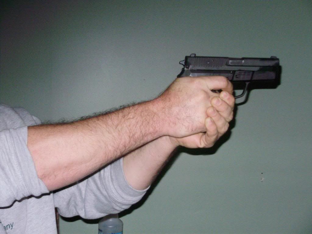

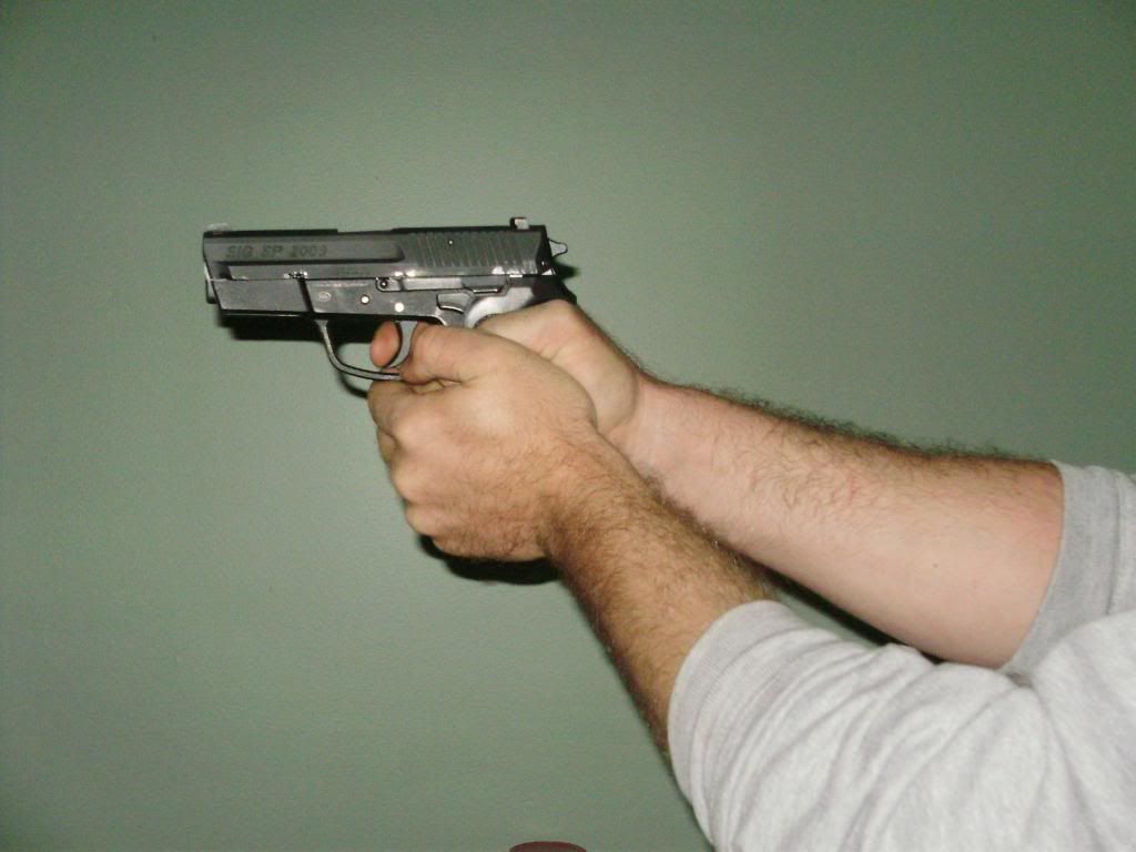

      Still havent gotten to the range but heres a few pics of my grip... my fiance wasnt real excited about taking the last one...lol... I had to show her it was unloaded twice.. better safe than sorry ..lmk if you guys see anything wrong, thanks alot

      Aside from the aforementioned "finger OFF the trigger" comment, nothing fundemantally wrong with the grip. When firing, however, is your right wrist firmly locked or does it flex back with the recoil (limp wristing is what it's referred to as). This would cause stove piping as your wrist flipping back absorbs energy that would otherwise be diecrted to the recoil spring. Taking that energy from the slide away from the action only partially ejecs the spent case as the ejection port isn't allowed to open fully, thus trapping the case within - stove piping.
      I generally use WWB as range ammo in all of my handguns and have not ever had a problem. It could also be possible that it is not adequately lubed. SiG's like to run wet rather than dry. I have another post in the SiG section listing the major points of lubing. If you need more info, just ask. I'll take more pictures and point out specific areas that need attention.

      *shutters at last photo*
      Depending on how you stand, I'd try the following.
      1. Thumbs laying parallel to each other along the slide.
      2. Straighten both arms. (This directs recoil energy down both arms, helps to prevent twisting during recoil.
      3. Square shoulders to fiance`, er um... target.
      The pistol looks well oiled, you can see it along the slide in the photos. I'd focus more on grip, arms and stance. Good luck!

      His stance looks a lot like mine. I don't have both elbows locked out like many will. I like to give a little less of a target back so I'm never square with the target, I turn a little having my left foot a little more fwd (left handed).
      I really don't see a lot wrong with the stance. Unless your wrists are giving too much when the weapon cycles.
      Last pic is a little spooky eh? Seemed to be sighting in pretty well though.

      Having that right thumb tucked down may be leading to a little less strength in preventing recoil absorbtion by the wrist. Extending it and going with the "parallel thumbs" grip would improve that aspect. Also spotted a slight cant to the left, minor but contributing factor. Alignment with the frame of the stance (bones and in particular, those in the arm) are primary in allowing properly efficient recoil function. Every little bit takes that much potential/kinetic energy out of the equation. The cant would (all else being equal) also affect grouping POI, especially at longer ranges. Obviously not much of a factor at 7 yds (20 feet) or less unless shooting bullseye competitions.
