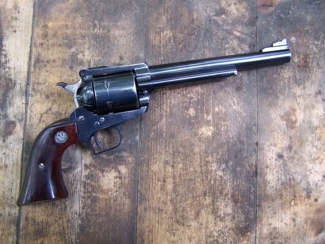

    If you can, maybe post some pics...definately before/after style!
    Bob Wright's Avatar
    Bob Wright is offline Senior Member
    Memphis TN
    1,518
    Well, this is before:
    The gun originally had fake pearl grips. I had an old pair of factory grips as I couldn't bear to photograph the gun with those old pearl things.
    "After" is still pending.
