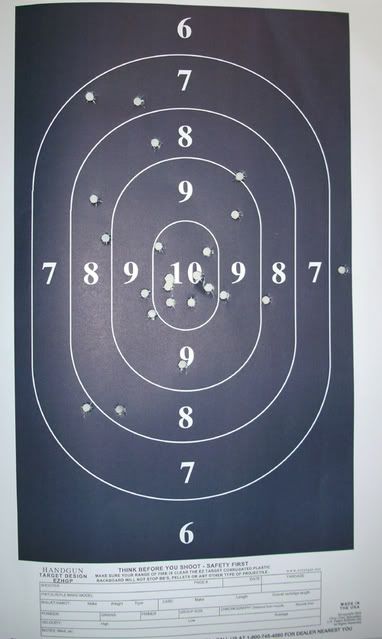

      This is not the first time I took my baby to the range. This was the second. First off, I was pleased with my choice of weapon for concealed carry. It looked good, felt good, and shot well too. The only thing I didn't like was the really heavy trigger pull. So I fixed it.
      I went to rugerforums.net and downloaded the IBOK which explained how to smooth out the trigger action. I polished the internal parts, focusing on the trigger sear and any sharp or rough parts. This improved the action about 10% in my opinion. I was pleased and fell in love with the gun. Well, I went one step further. I replaced the factory springs with Wilson Combat reduced power springs. I used the 10# hammer spring in combination with the 10# trigger return spring and OH BABY!!! The new trigger action was smooth as silk. I can pull the trigger with my pinky finger. Light, smooth pull with a clean, crisp break.
      So I fed it some Blazer .357 MAGNUM 158gr hollow points. I didn't do any shooting beyond 7 yards today due to the fact it wasn't the best day to go to the range. It was cold and wet. But I was anxious to try out the new trigger action. SO I set up at 7 yards and ran 100 rounds through it.
      This is double action rapid fire.

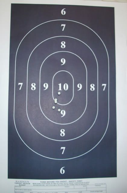

      This is 5 rounds in single action.
