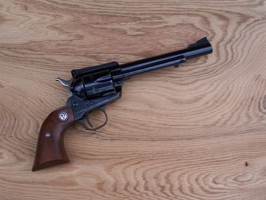

    I bought this old three-screw .357 by answering an ad in the paper. It had the transfer bar action installed, no original parts. I found the hammer on the Ruger forum, bought the trigger from Dave Clements, and bought the steel grip frame from Brownell's. I fit the grip frame, furnished in-the-white, and cold blued it with Birchwood Casey's DeLuxe Blue. Not quite a professional job, its servicable until I can get it done better. Its an upcoming project.

    Looks like you did a pretty good job!
    Might be a good .357 shooter, or a candidate for conversion to .44 special.
    Brings back good memories of my first revolver. Wish I hadn't sold it.
    Oh, well...I needed the money for a different gun, a Blackhawk .41 mag.
    However you use it, "Ya done gud!"
