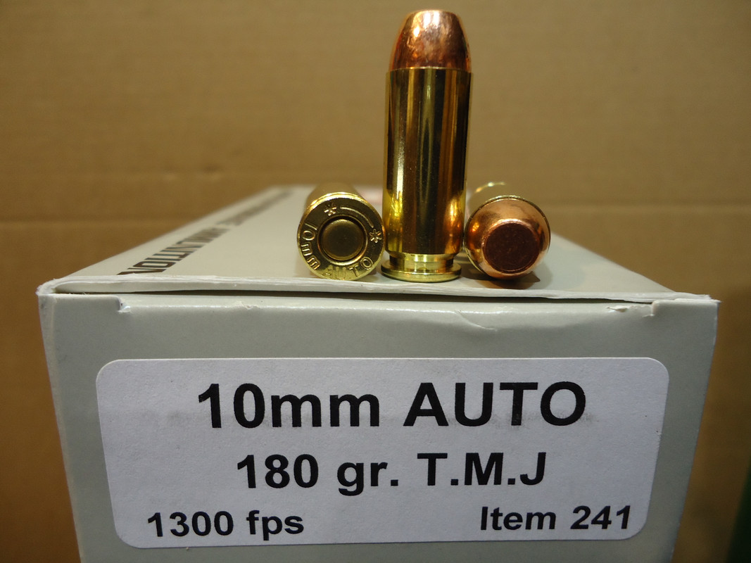

    I found the C.O.L. to be 1.245”

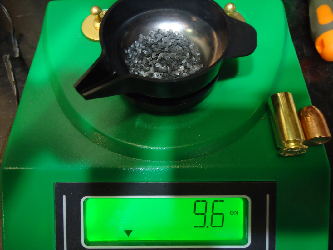

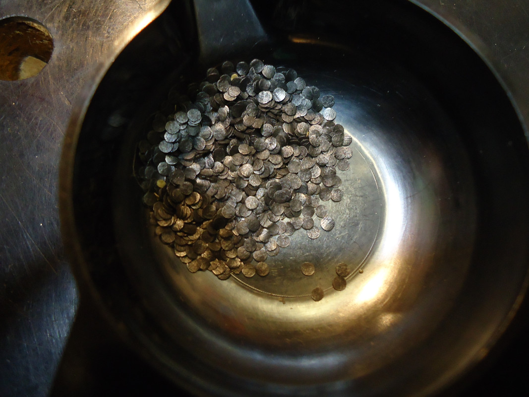

    Taking a look inside I found 9.6gr of propellant that looks very much like 800-X.
    A closer look;

    First, I was surprised to see such a significant velocity spread in both groups. I had velocities as low as 1155fps and as high as 1275fps. Now If I was to try to use any kind of powder measure with 800-X, I know what would happen.. Large weight variations.. So I wonder if that is happening here. I am tempted to pull down some more rounds and see what variations there might be.

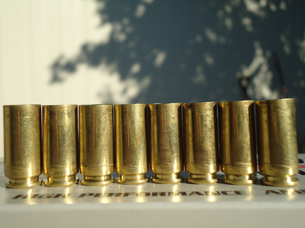

    Second, this ammo is warm. Many of the fired cases produced smileys..
    The cases that did not have smileys measured;
    .4340, .4392, .4348, .4343, .4341.. These must have been the rounds that shot in the 1100’s.
