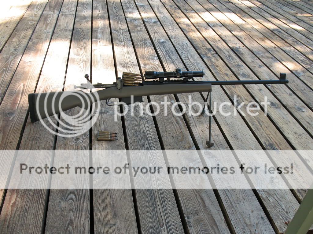

    Here's my old "Semi-Scout" practical-shooting rifle, finally in its new stock after having waited 12 years in our basement in pieces. It's a M1903 action from the mid-1930s, with a 1943 barrel, Lyman and Burris sights, and a 10-round magazine.
    (The AP rounds are collectors' items from WW2.)
    It'll hold about a minute-of-angle from the bench, which is far better than I can do in the field. That bipod helps a lot, of course. It's an important feature of this new stock. (Previously, I used a Colt's "clothespin," hung on a separate boss built-onto the fore-end.)

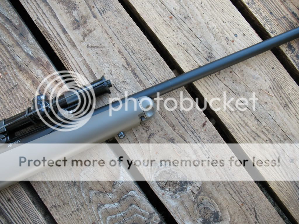

    Here's the bipod completely stowed away, becoming the stock's fore-end tip!
    Neat, huh?

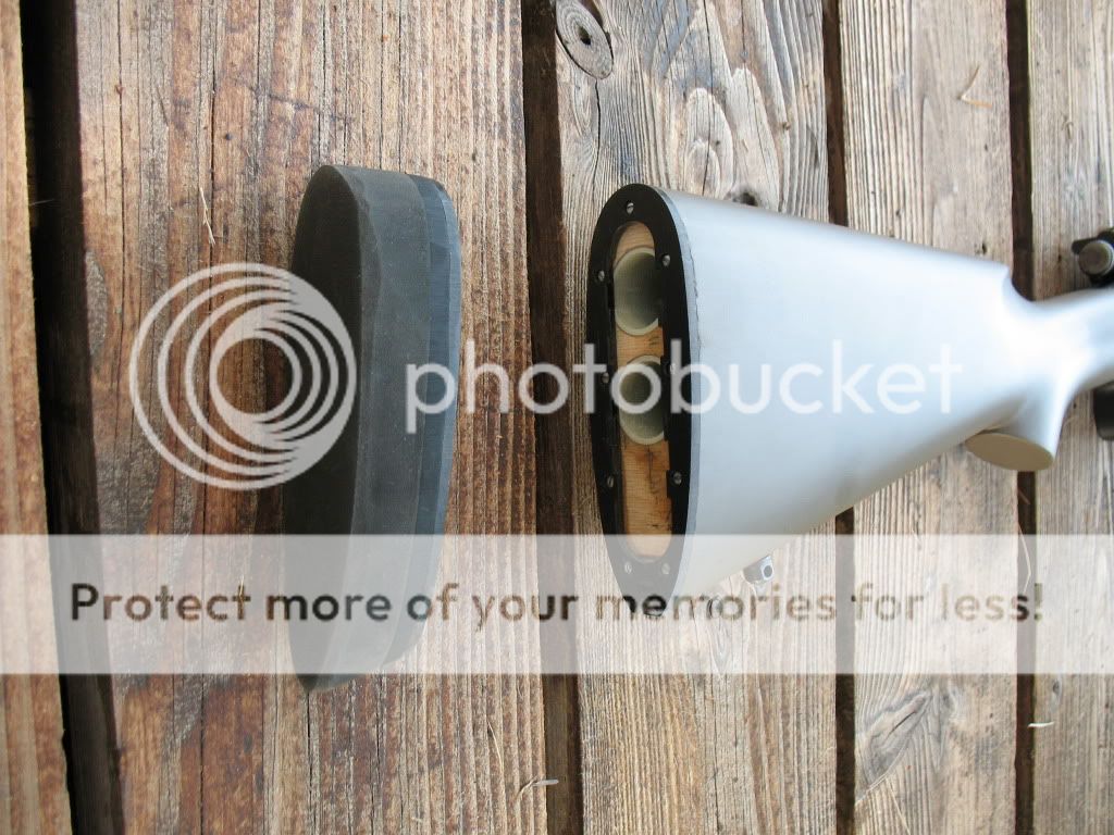

    Pachmayr used to make and sell this neat removable butt-pad assembly. It attaches with an interrupted-dovetail sort of arrangement, and it is held in place by a very strong latch.
    I added Fiberglas tubes, both as stock stiffeners and as a place to stow a cleaning rod, tools, and spare parts. One of the tools is a wrench for the scope mounts.

    A fine rifle, with a nice combination of features, some of which are darn clever.
    I especially like the magazine; it appears well designed and executed!
    The sloped front scope ring looks to be an extension of the angled line of the scout scope mount base. Bravo!
    Hope it shoots well for you!
