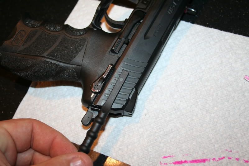

    One other issue, is that when carried C&L, there is a cavernous amount of open space for dirt, lint, etc. to build up in the hammer & sear components.

    Regarding the dust trap in the slide, here are some more pictures:
    It catches a lot of lint in there when worn under a polo.
