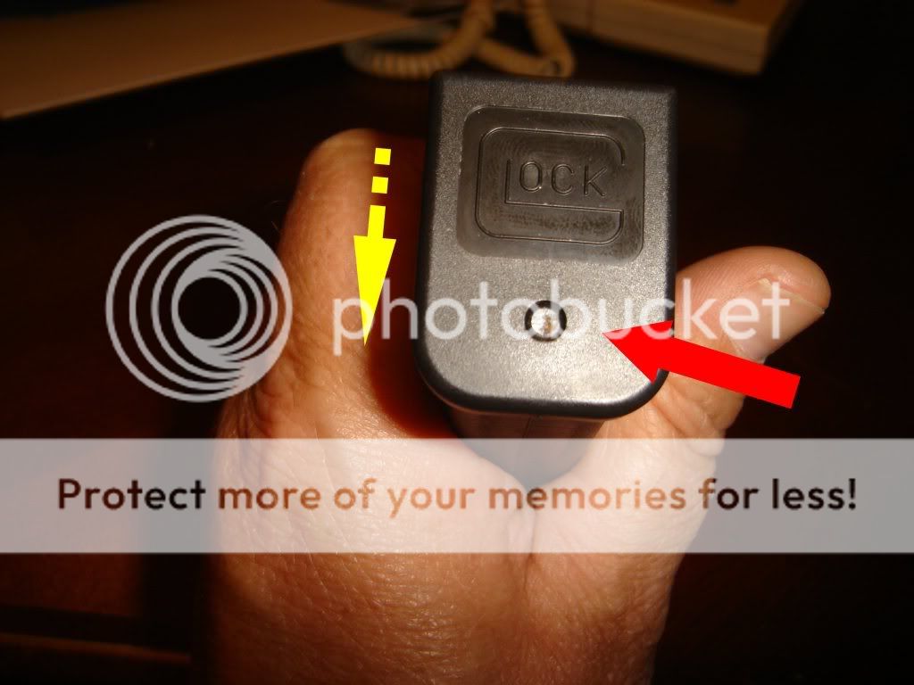

    C-clamp ouch! Here is a picture of the bottom of a glock 23 magazine - I am assuming they are all the same.
    Simply push down the pin - pointed at by the red arrow - with a punch tool or as I use a small phillips head screwdriver and carefully
    slide the bottom off the magazine in the direction of the yellow arrow.
    Remember the base is holding back a compressed spring so as you slide the bottom off with one hand keep your other
    thumb on top of the lock plate to keep the spring from shooting across the room. (or into your face)

    SaltyGod thanks for the reply. Maybe the model 26 is different. It has the button on the bottom as you showed, but it also has lugs on the side of the magazine that fit into slots in the floor plate. You have to depress the button on the bottom as you described plus you have to squeeze the sides of the magazine until the lugs disengage from the slots. While holding all of that you can slide the floorplate off. Its a simple job if you have 3 hands.

    Well I had to see for myself and you're absolutely right David_S there are tabs on the sides and I sure didn't have the stregnth to push in the sides.
    What I did was to rest the phillips head screwdriver blade against the spring and pry the floor plate off of the tabs. Much easier than trying to compress the sides.
    In that You Tube video that guy either has an iron grip or his magazines are weak because I sure could not get the sides of my magazine to move like he showed.
