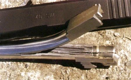

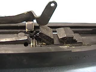

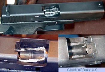

      Documented kB!s in http://www.thegunzone.com/glock/glock-kb-faq.html show barrel/chamber bursts.

      Glock kB!s have been documented using standard pressure .40cal factory rounds:
      Quote Originally Posted by Ken Hackathorn, World Class Firearms Instructor
      In various handgun courses over the years I have personally witnessed five (5!) kB!s, all with factory-new .40 S&W ammo. Yes, two were with the earlier Federal 165-grain Hydra-Shok, but I've also seen it happen with 180-grain Winchester Ranger and 155-grain Speer Gold Dot HPs
