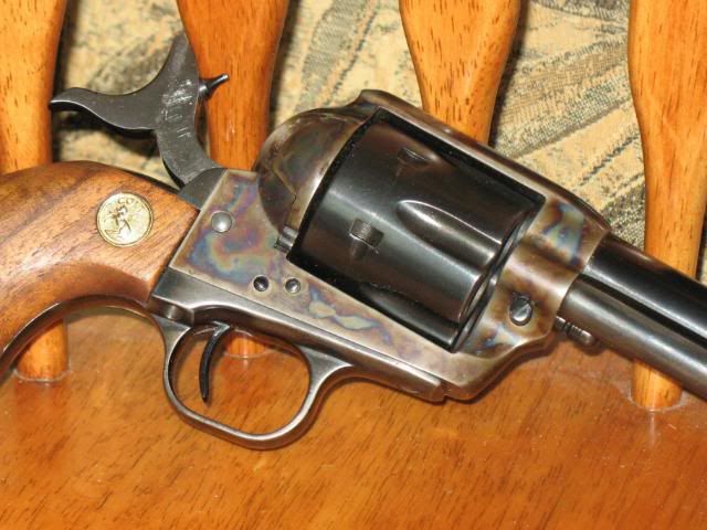

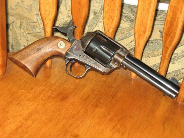

    Sample of True Case Hardening...
    Here's a picture of my old (1977) Colt .45 LC SAA. A well engineered and finished revolver with extraordinary handing and shooting characteristics:
    As the old Texas Ranger once said, ...."she'll do to ride the river."

    Crestliner, that's pure Class.

    Bear in mind there is Case hardeneing, and case COLORING.
    Case hardening was done to surface harden the steel of the day, current steels and tempering make the surface hardening unnecessary. However, it is a handsome finish and highly desirable to some, I among those.
    The clones of the Colt are truly case hardened. The case coloring done by Doug Turnbull is a fire applied coloring that duplicates the color but does not surface harden the steel. The coloring used by Ruger on the Vaquero models is an applied finish, using a dye process.
