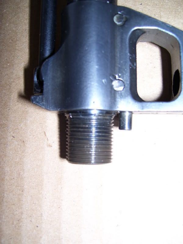

    The barrel was threaded, and instead of removing the threads or welding a sleeve over them, they rolled the threads flat to keep a muzzle device from being installed. I was able to raise the threads with a die to the point of being able to hold the slant brake in place. It's a little loose, but it isn't going anywhere.
    You can see in the pic how the plunger was peened in place. The MAK90 I did in the tutorial wasn't even drilled for the plunger. The gas block was drilled for 2 pins, later ones were only one. This gas block had the Type 2 bayo lug. You can see how crudely it was removed. Only one of the pin holes lined up when the new GB was installed, I had to drill the other one.
