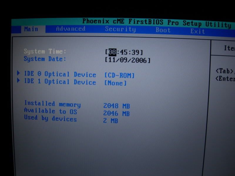

    Quote Originally Posted by Mr. P View Post
    What he said...go to setup (F2) and give us some pics of the screens.
    This what you want?
    I snapped this earlier, but I packed up my computer because I am leaving for the weekend. I will have to give ya an update when I get back.

    Quote Originally Posted by -gunut- View Post
    Yes, see that the ‘power on beep’ is disabled on the last pic? Enable it and save.
    Restart and count the beeps…beeps tell you what may is or is not working on the motherboard. But you need the specs for the board to know what is wrong for sure, as I recall, but it’s a start.
    3 beeps are good.

    One beep...

    490
    It's really tough to do this long distance; but, one beep during POST is good. That means that everything is probably OK and it's just a software problem, in that somehow, for some reason, the files the machine needs to start have been corrupted or are missing. I'm not going to try to troubleshoot your machine from here, but there's a good chance your data is not lost.
    The post from jpruett79 was good advice; I would try that process. If you're not comfortable doing that yourself, get to someone local.
    One beep...
    If it is a cold boot, the BIOS verifies RAM by performing a read/write test of each memory address. It checks the PS/2 ports or USB ports for a keyboard and a mouse. It looks for a peripheral component interconnect (PCI) bus and, if it finds one, checks all the PCI cards. If the BIOS finds any errors during the POST, it will notify you by a series of beeps or a text message displayed on the screen. An error at this point is almost always a hardware problem.
    The screen does show an error. Local tech time, gunut.

    447
    There shoould be a screen to show HDD0 or something. Looks like you have a RAID setup. Possibly your onboard RAID controller failed. I would move the hdd to IDE1 and see how it boots up. One beep is generally a good thing. If you DO move it to IDE1, then you will need to reset the bios bootup order to recognize it there. It is rather difficult to troubleshoot over the net.
