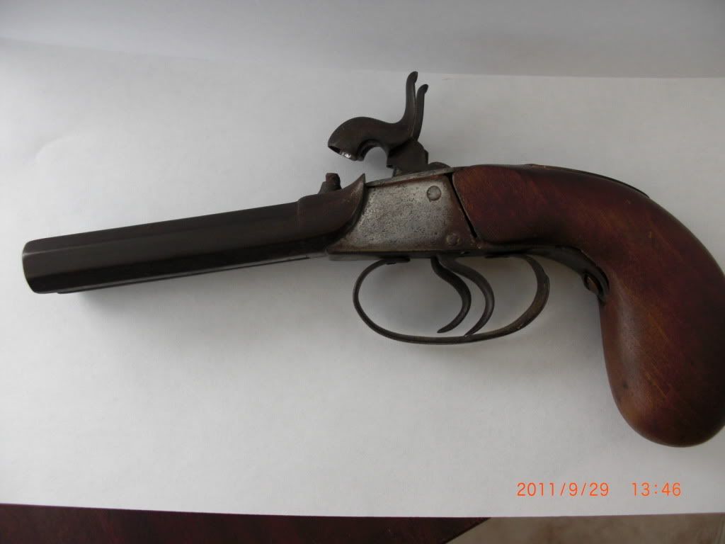

    need help I D'ing old cap and ball pistol
    Hi there guys,
    I am new to this forum. I joined for some help finding information about an old cap and ball pistol I have.
    My father told me he found it in a bombed out farm house in France dulring WWII. I have pictures but am unsure how to post them on this forum. I will describe it as best as possible.

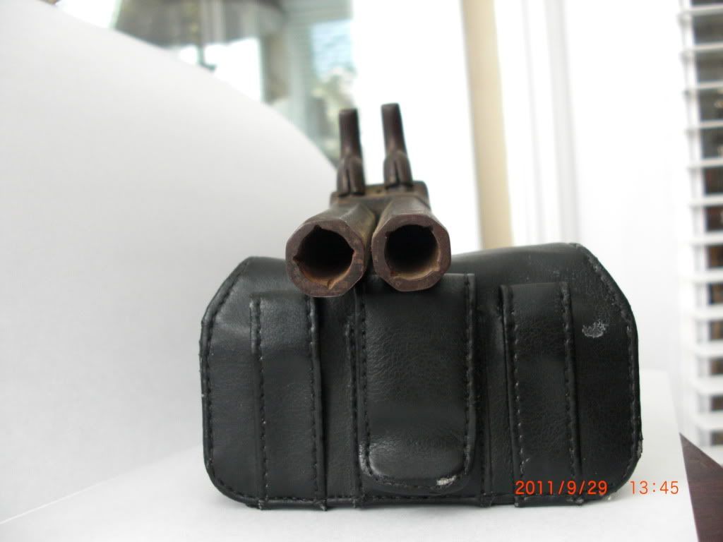

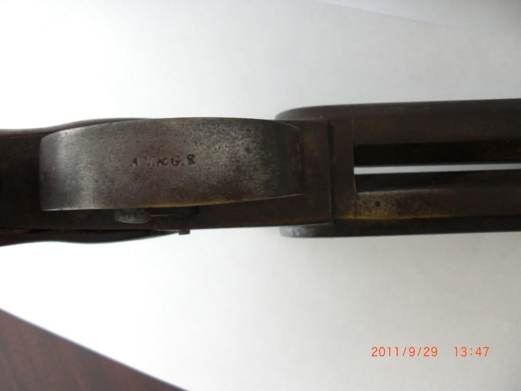

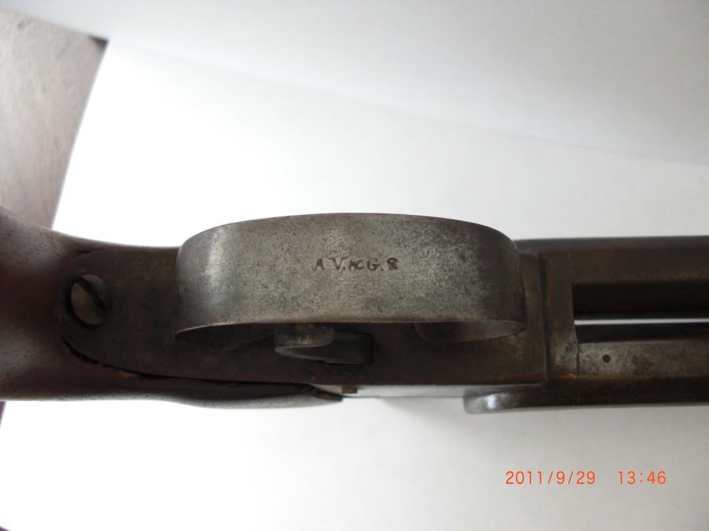

    It is about 7 3\4 inches long with a smooth curved wooden grip. It has twin , octogon barrels which have "rifleing" marks that can be seen on the ends of each barrel but unsure if the entire barrel is rifled. Twin triggers and hammers. The only "proof Marks" I can find are on the underside of the trigger guard. They are as follows:
    A.V. mc G.S or it may be A.V. 8c G.S
    If it is an 8c in the middle then the 8 and the c are so close they are touching.
    I have been looking on line for a proof mark that is somewhat like that and have been unable to find anything.
    My father passed away about 14 years ago and I recently "re-found" the pistol in the attic. Would really like any help finding out some history about this firearm .

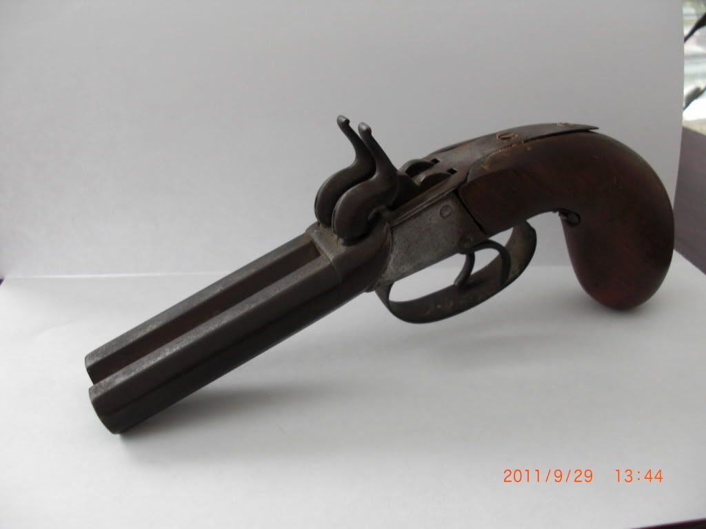

    found a very similar pistol at auction here
    Crescent City Antique Gallery
    they date their pistol from about 1840.... since the percussion cap dates from about 1830 and the gun doesnt appear to be a retrofit i think yours is pretty close to that date. your gun looks to be the same style and may be from the same maker.
    i checked my list of all the major european proof houses for the marks on the trigger guard and can not find anything matching. my guess is that the marks are the gun makers mark.
    4,110
    I believe that, as usual, Ted is correct: It's a Belgian pistol that would be described as "bag-butt, screw barrels." However, there's an outside chance that it may be English, too.
    Note that the Crescent City Gallery does not list a maker for the pistol they're selling. There were so many small gunmakers in Belgium that the initials on the trigger-guard of your pistol, though clear, would probably prove difficult to trace.
    (An English gun of this period would have distinct, visible proof marks, while a Belgian one made for export might not be so marked.)
    The shape of the hand-grip, like a cloth bag or even a bull's scrotum, makes the term "bag-butt" appropriate.
    The four notches you see in the muzzle of each barrel fit a wrench which came with the gun (now probably lost). With the wrench, you could unscrew the (certainly rifled) barrels individually. Removing a barrel would present you with a hollow, tube-like chamber into which you would pour a measure of black powder, which would then be topped by a round ball. The chamber will be found to be of slightly larger inside diameter than the bore of the barrel, to make loading easier.
    The length of the inner chamber would automatically limit the amount of powder you could put into it, and its interior diameter would limit the diameter of the (soft lead) ball. Thus, a safe charge was guaranteed.
    IIRC, sometimes the barrel wrench would include a built-in bullet mold.
    If you intend to explore the barrels' interiors, I suggest removing the wood and then soaking the entire piece in penetrating oil, while you fabricate an appropriate wrench to very closely fit the barrel notches.

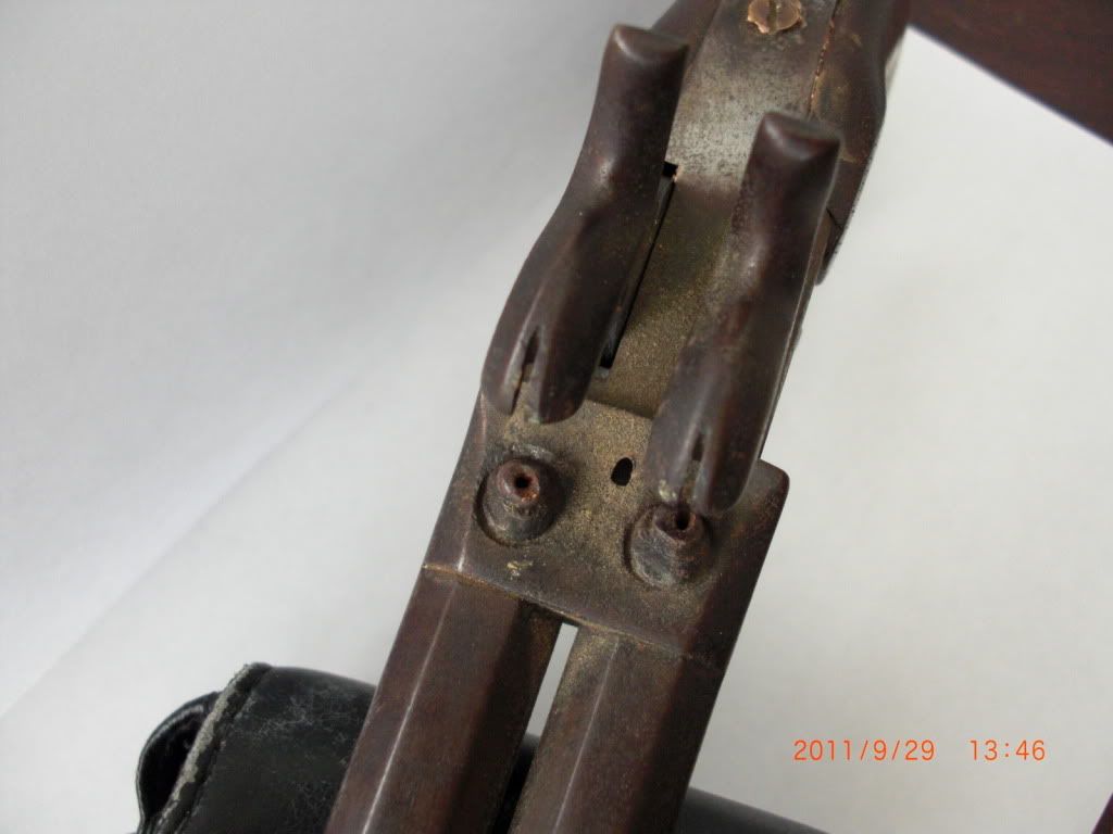

    This soaking would also make further disassembly easier, allowing exploration of the lockwork, which should consist of separate mainsprings, sears, and triggers, the sear notches being an integral part of each separate hammer.
    I am willing to bet that, because of its condition, this pistol, though historic, will be found to have little sales value.
    The best thing to do is to clean it carefully, but without any attempt at removing its corrosion-caused "defects," which actually add to its value.
    You might try to trace the ownership of the property on which it was found, in order to discover any historical associations with the pistol. Considering its date, it may have Civil War or Western Expansion associations.
    Oh, yes: Don't try to shoot it!
