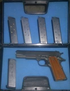

    I finally bought my first 1911 pistol. I have a Rock Island Armory .45 and I love shooting it. Recently I learned how to field strip it , clean and oil it, then reassemble it. However last time I went shooting the pistol started to jam after about 60 rounds. I took it home, field stripped it, and noticed a lot of buildup and upon wiping it down, my cloth was black as night. I probably added too much oil last time I cleaned it, but now I have to ask, how much oil is enough to keep the pistol properly lubed and functioning properly?
